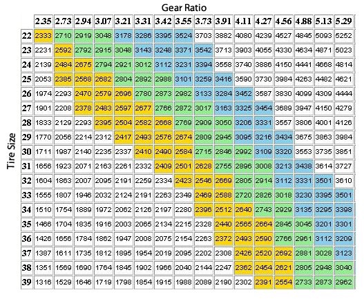

The regearing is to gain back high gear in auto trans. Even in manual. Are you able to pass or pull a incline and hold speed at or above 65mph in top (5th) gear? Auto trans lose high gear and cannot maintain highway speeds.
Normal driving should occur between 2250 and 3000 RPM.  This is the max efficiency for the engine without lugging. Lugging or loading the engine  (below 2250 rpm) over a long time results in engine damage.
A lot of engineering went into this chart. I’d follow it.
 from Quadratec.com
