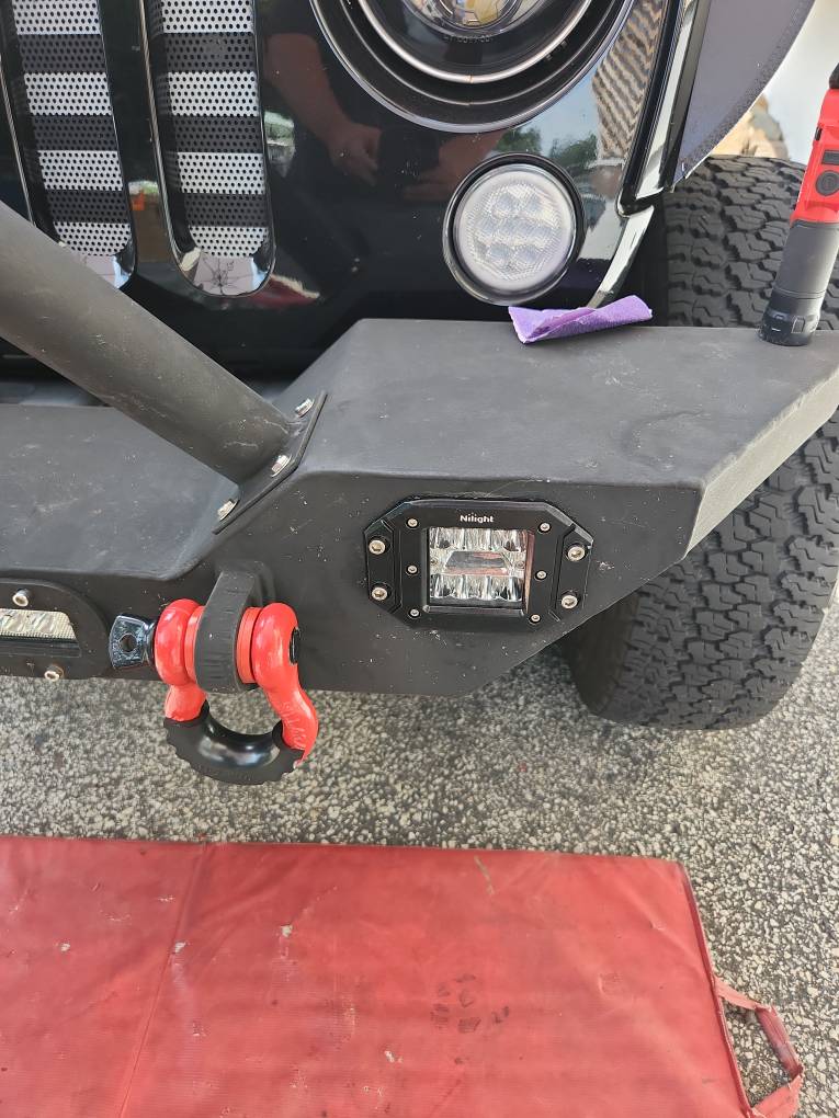

... finally done with those yellowing crappy LEDs that I got tired of looking for replacements for.

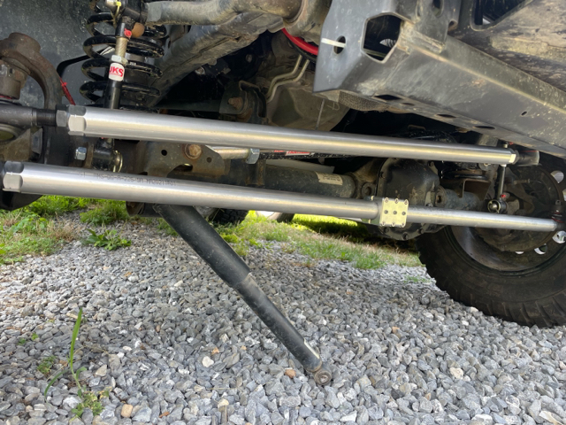

Is it me or is your drag link at a different angle than your track bar??
This leads to bump steer. Hit a bump and the wheel gets jerked out of your hand.
