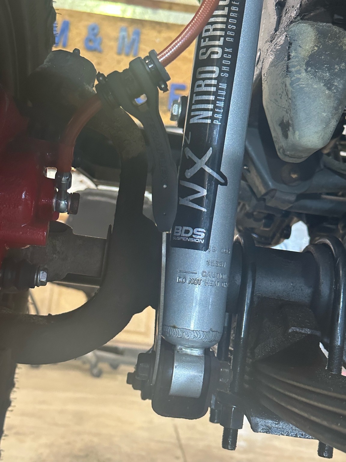

Second issue was the front brake hose have a hold down tab that crimps the hose. This became a blockage, so the brakes would ride on that caliper wearing and overheating..
