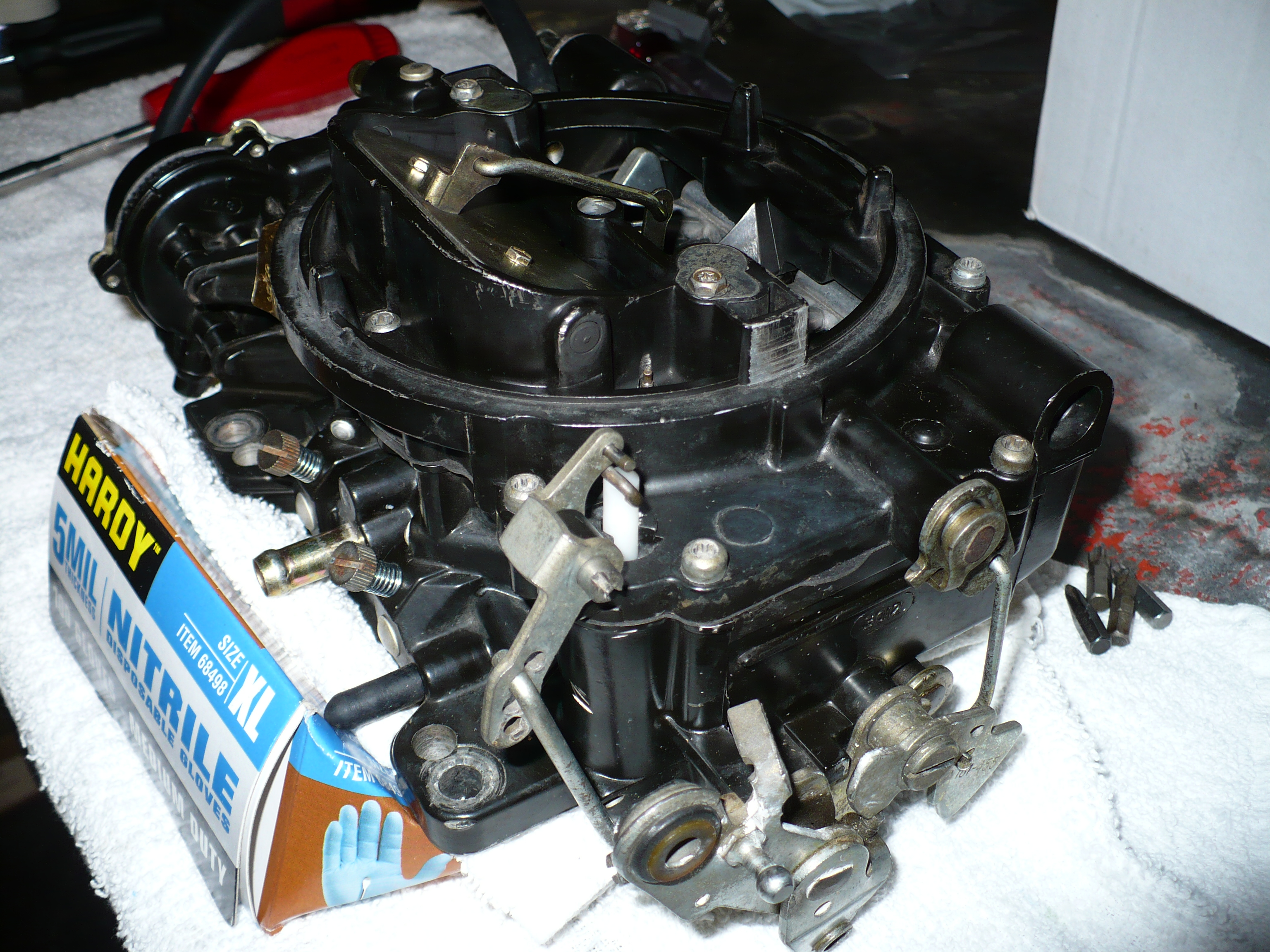

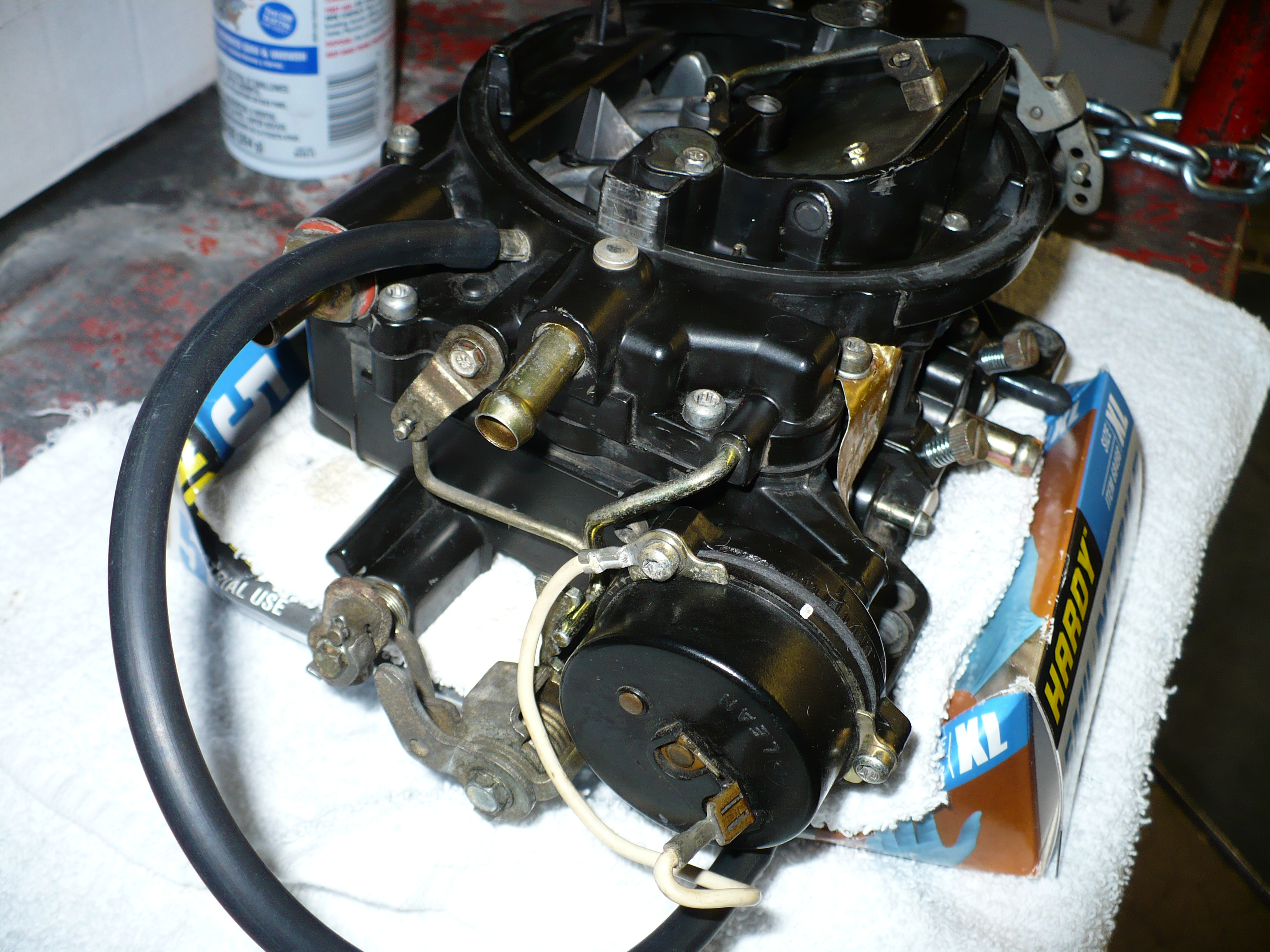

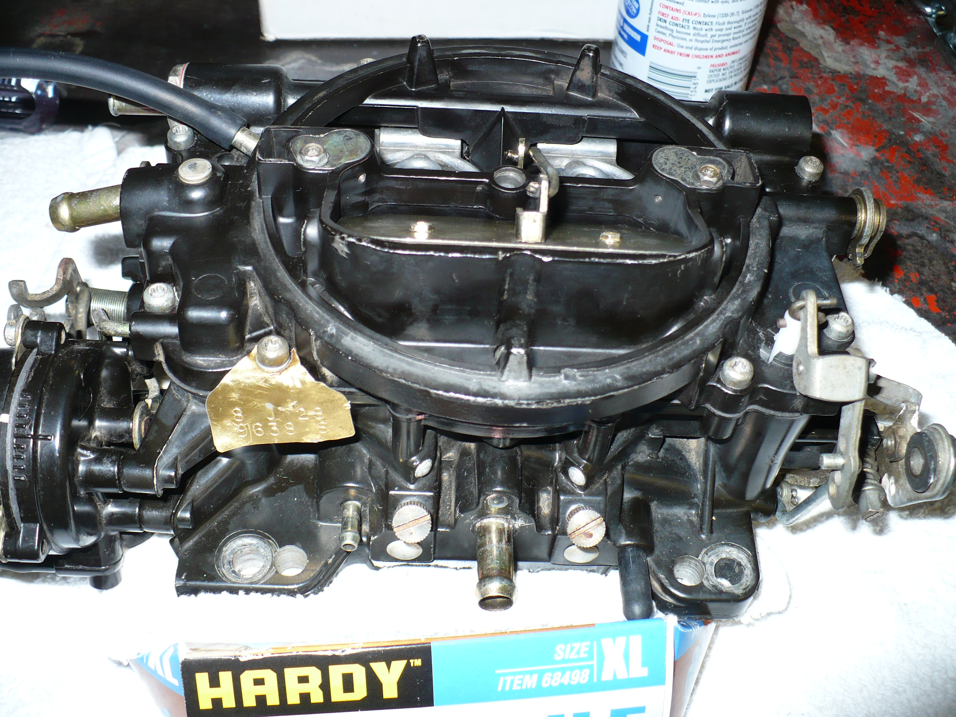

Just in case anyone wondered what a 'Black Stallion' edition Carter AFB looked like;

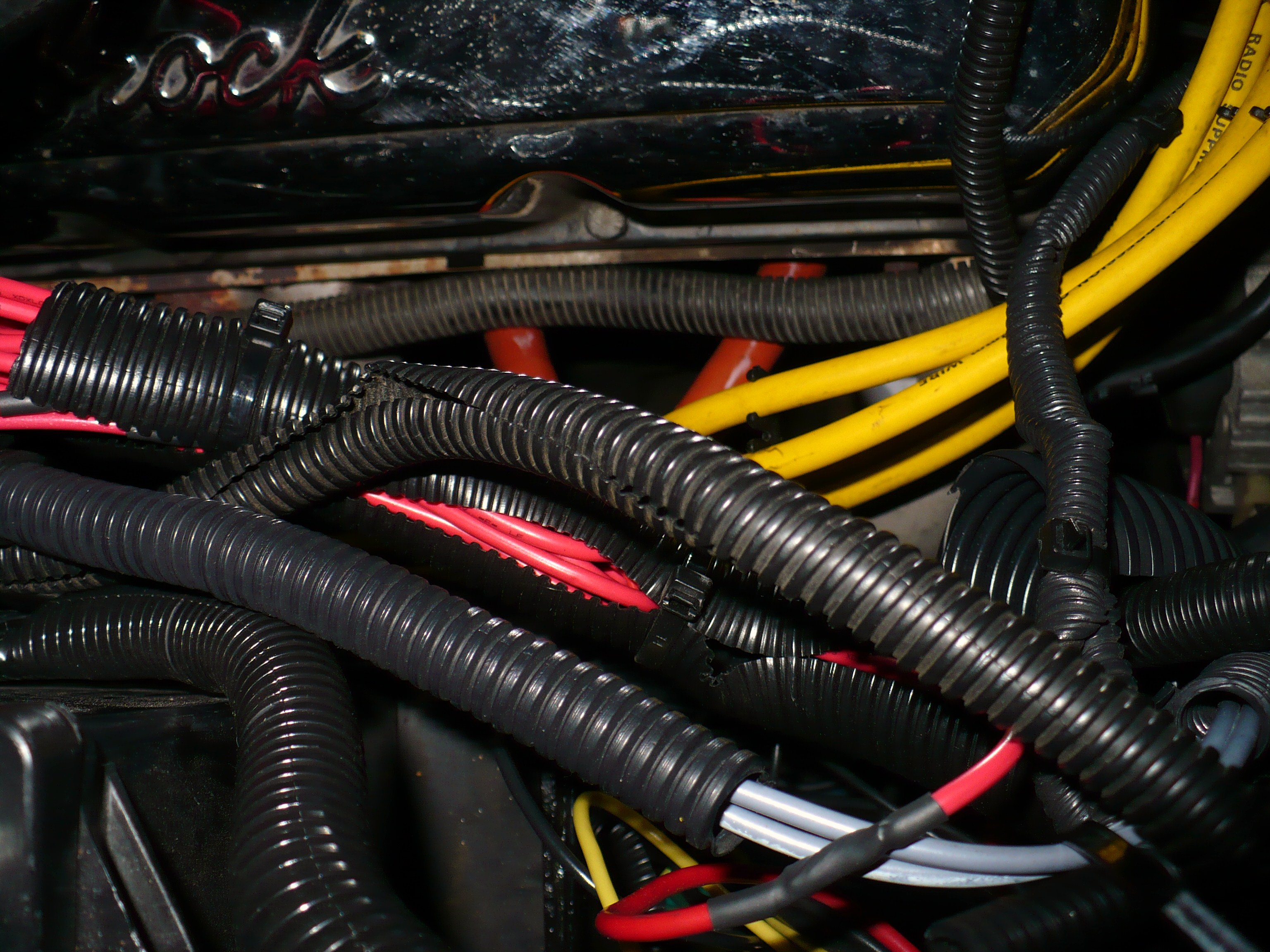

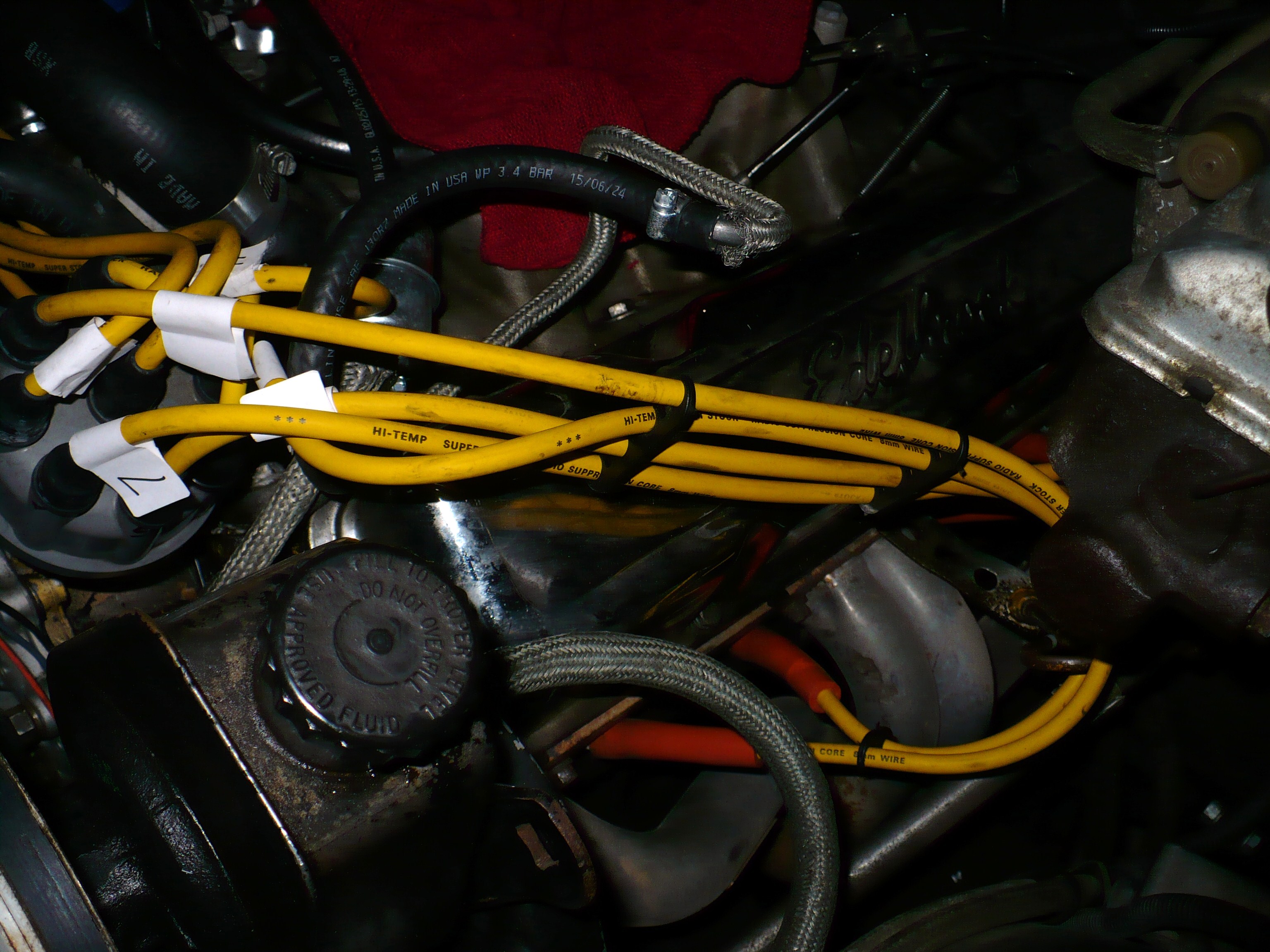

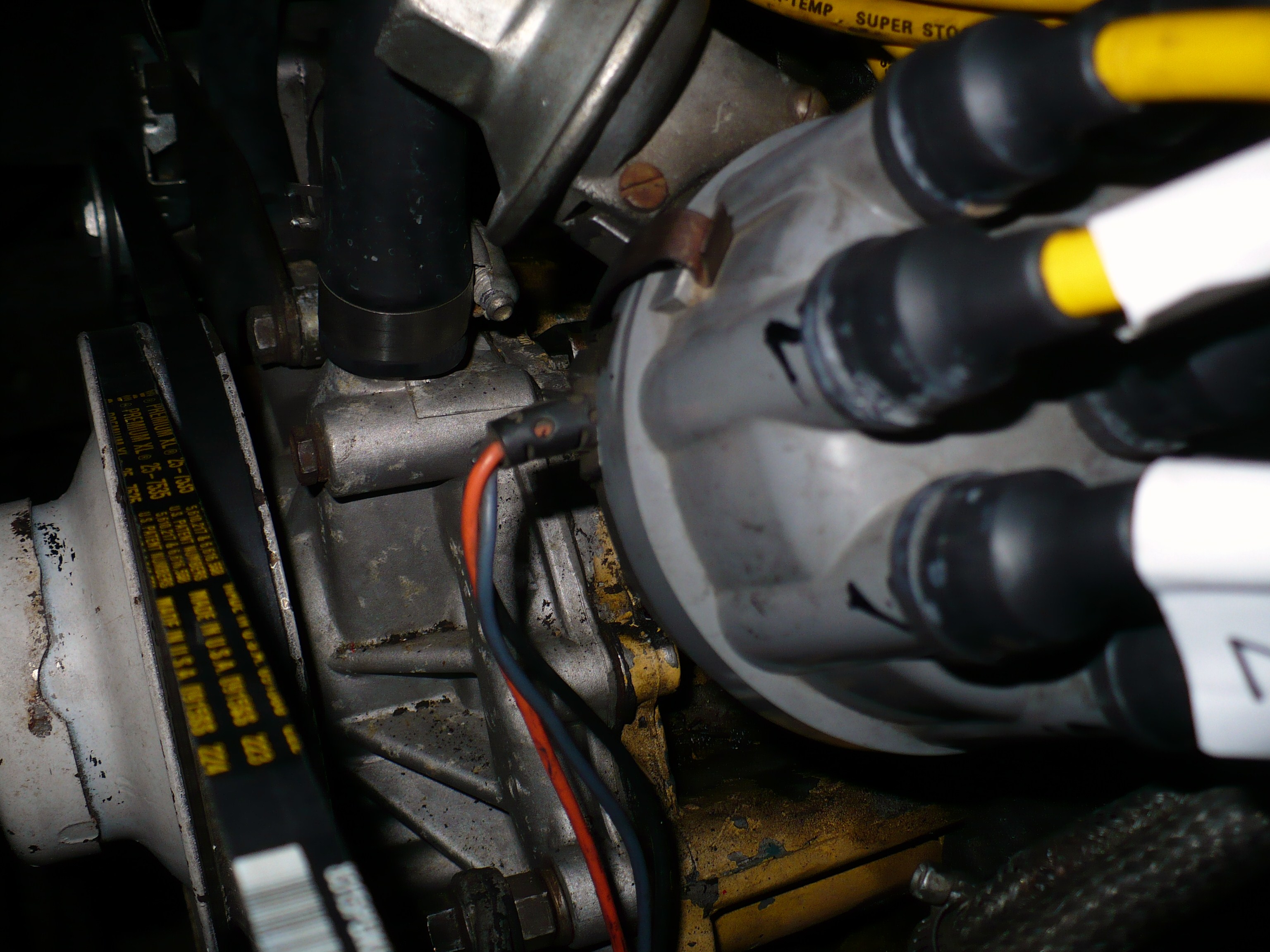

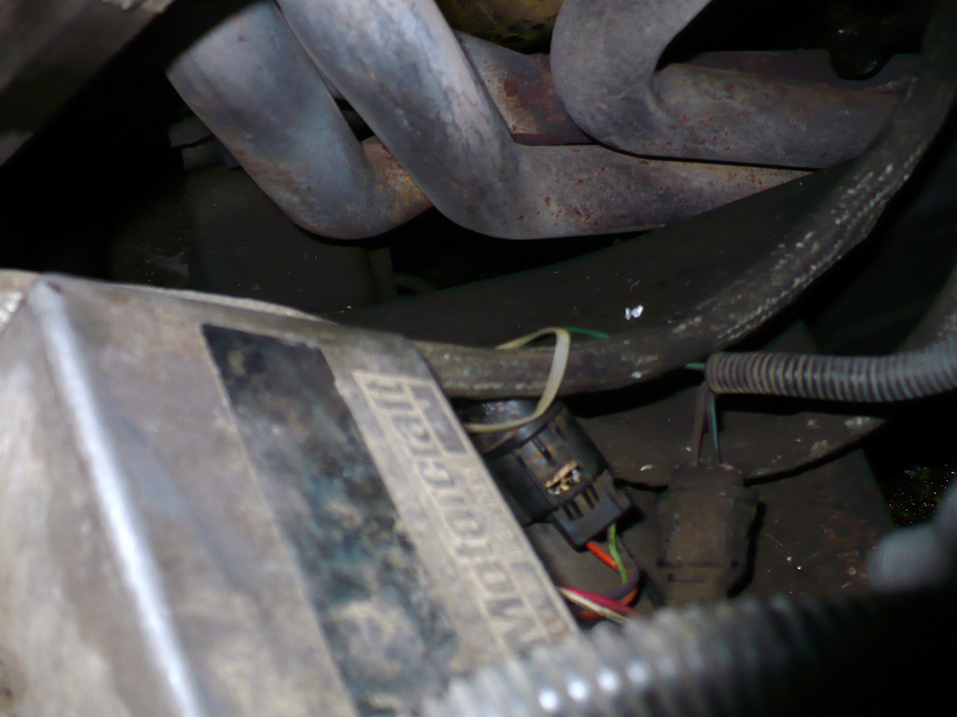

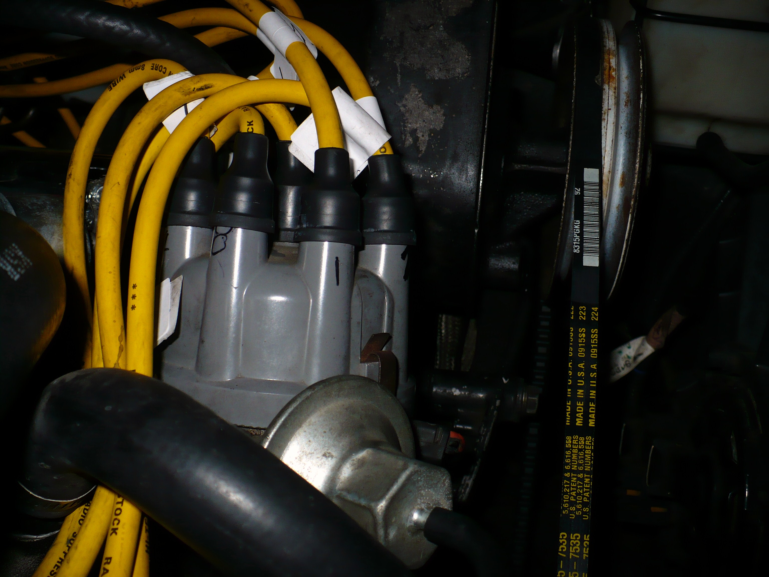

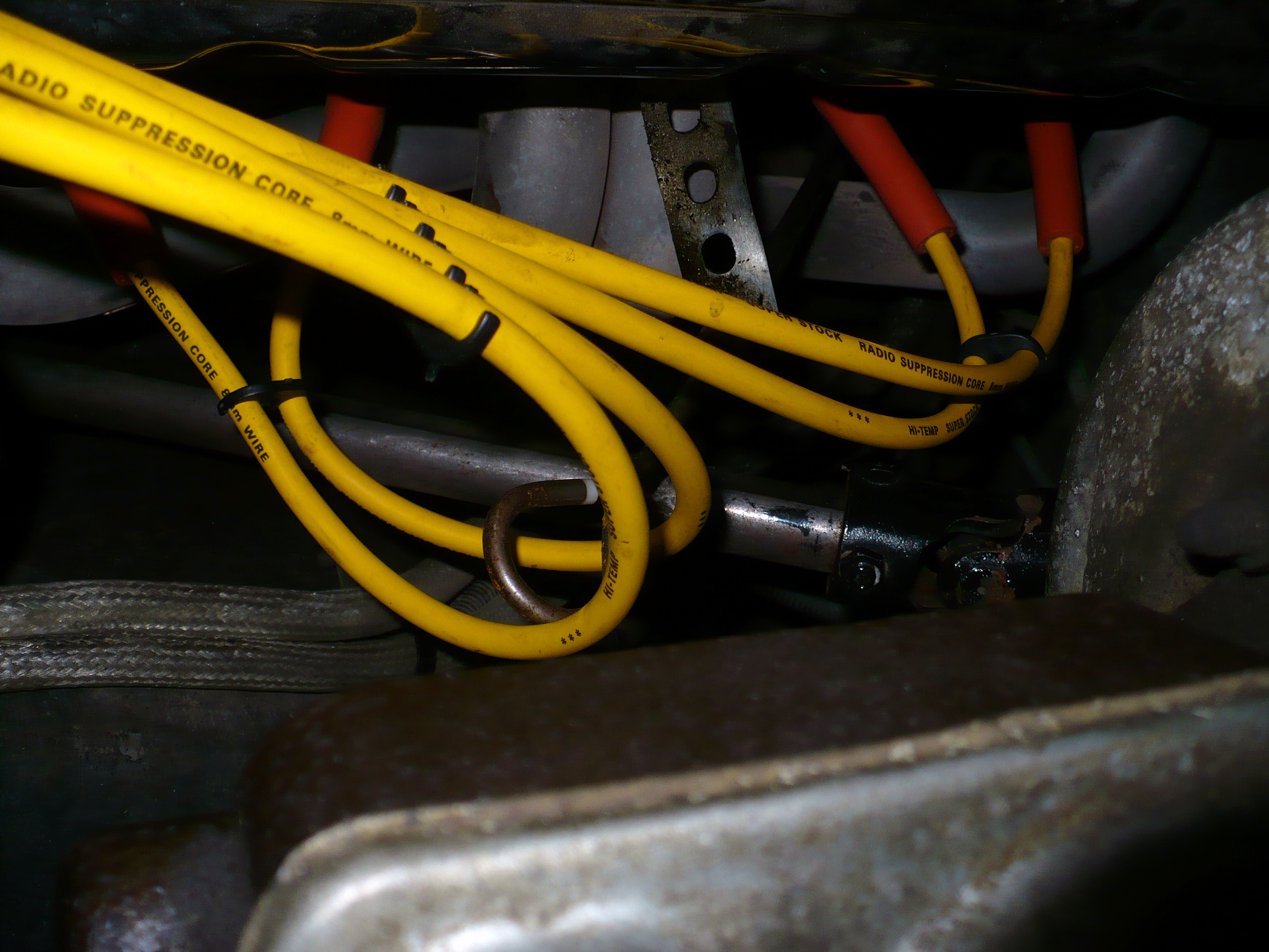

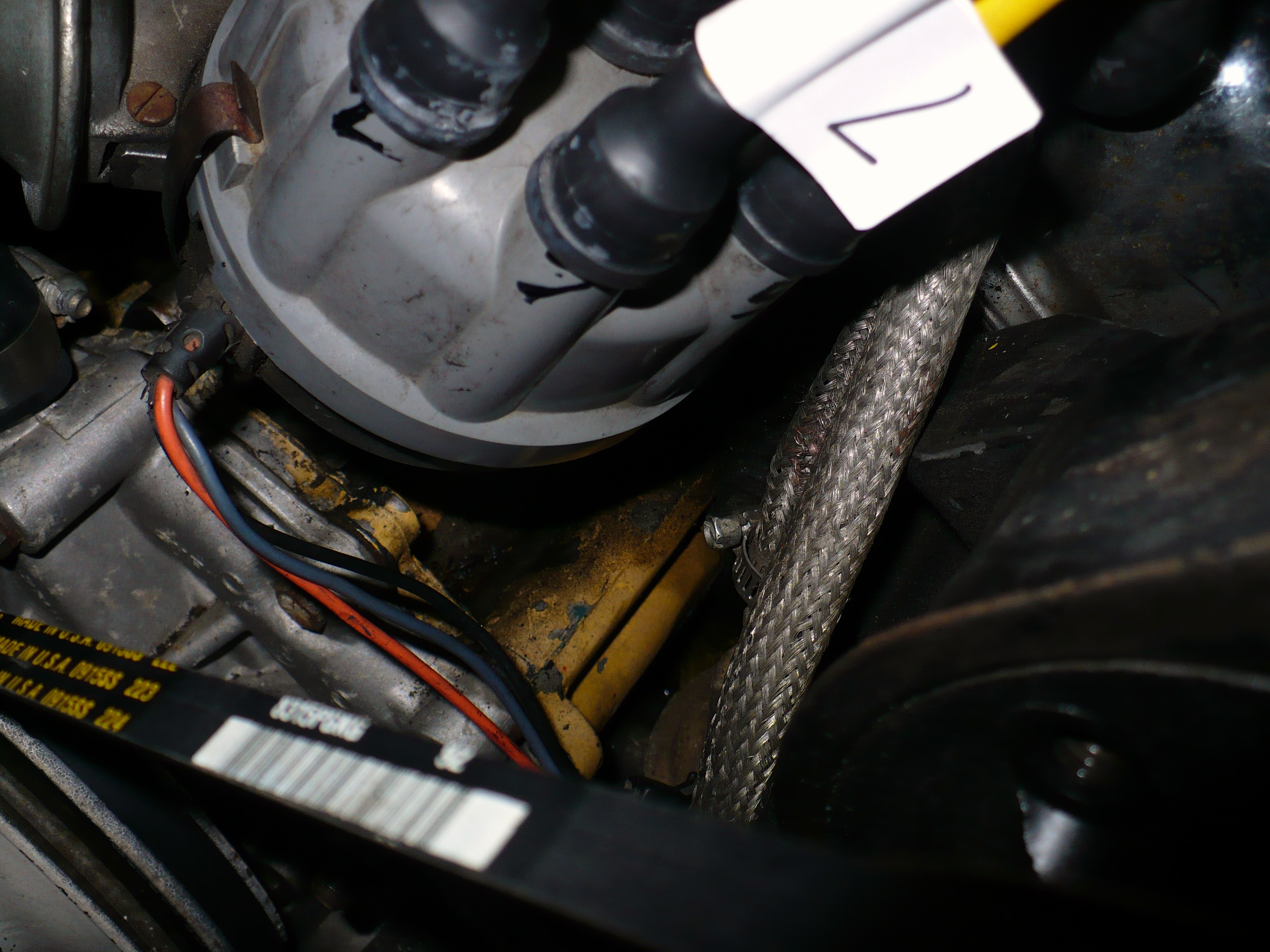

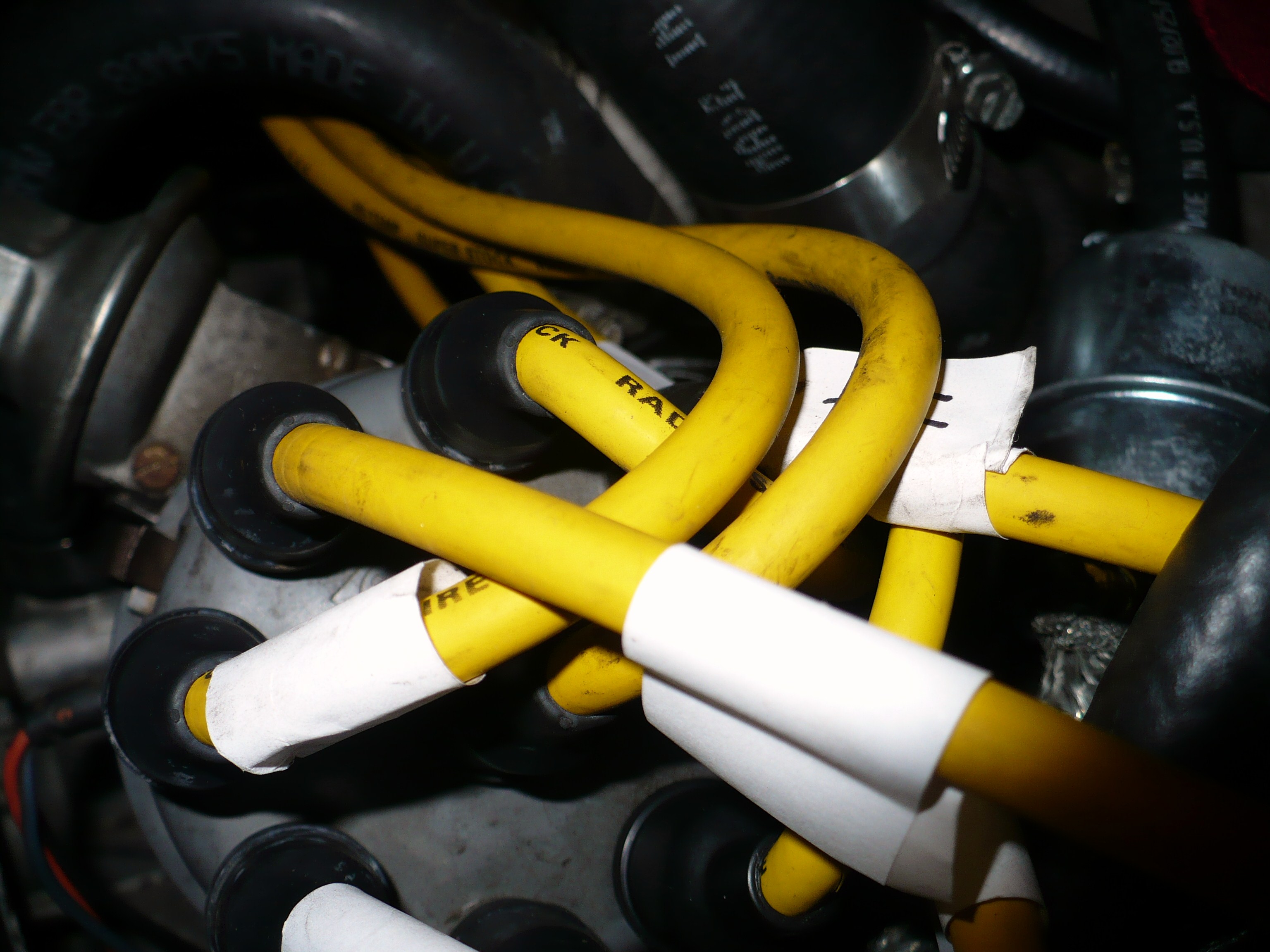

So, on another forum it's been called to my attention that given all the work on the carburator my issue must be with the distributor/spark plug wiring. Here's a few pics of what it looks like, any red flags?
So how does wiring cause fouled plugs?
And just thinking about this.... These seem to foul rather fast.
Have you checked compression? Is there oil in the cylinder or gas in the pan?
You do know you are getting enough air? Is the exhaust clear?? Post a pic of a fouled plug. Please

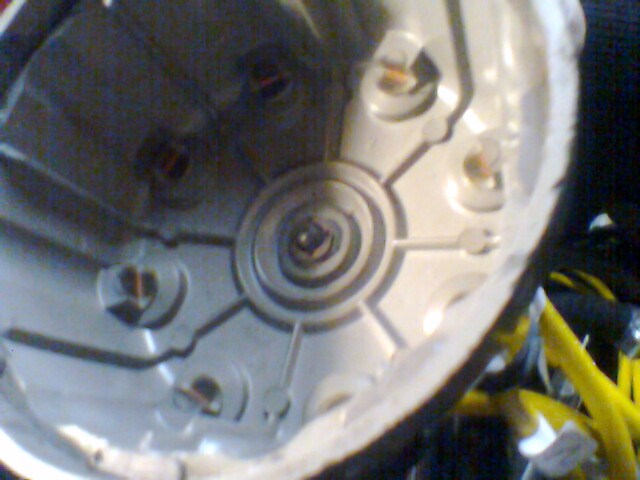

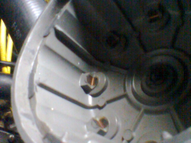

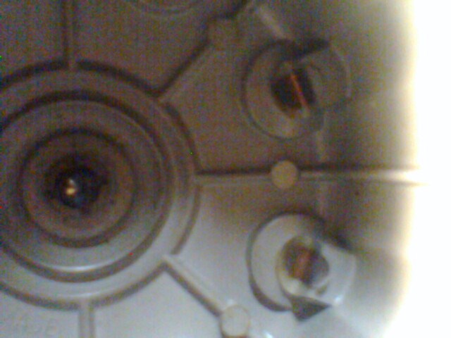

When I get home tonight I can take some plug pics, in the meantime here's the cap and rotor (sorry for the poor quality on my old phone)
I'll take some cap and rotor pics with my standalone camera for better clarity tonight.
