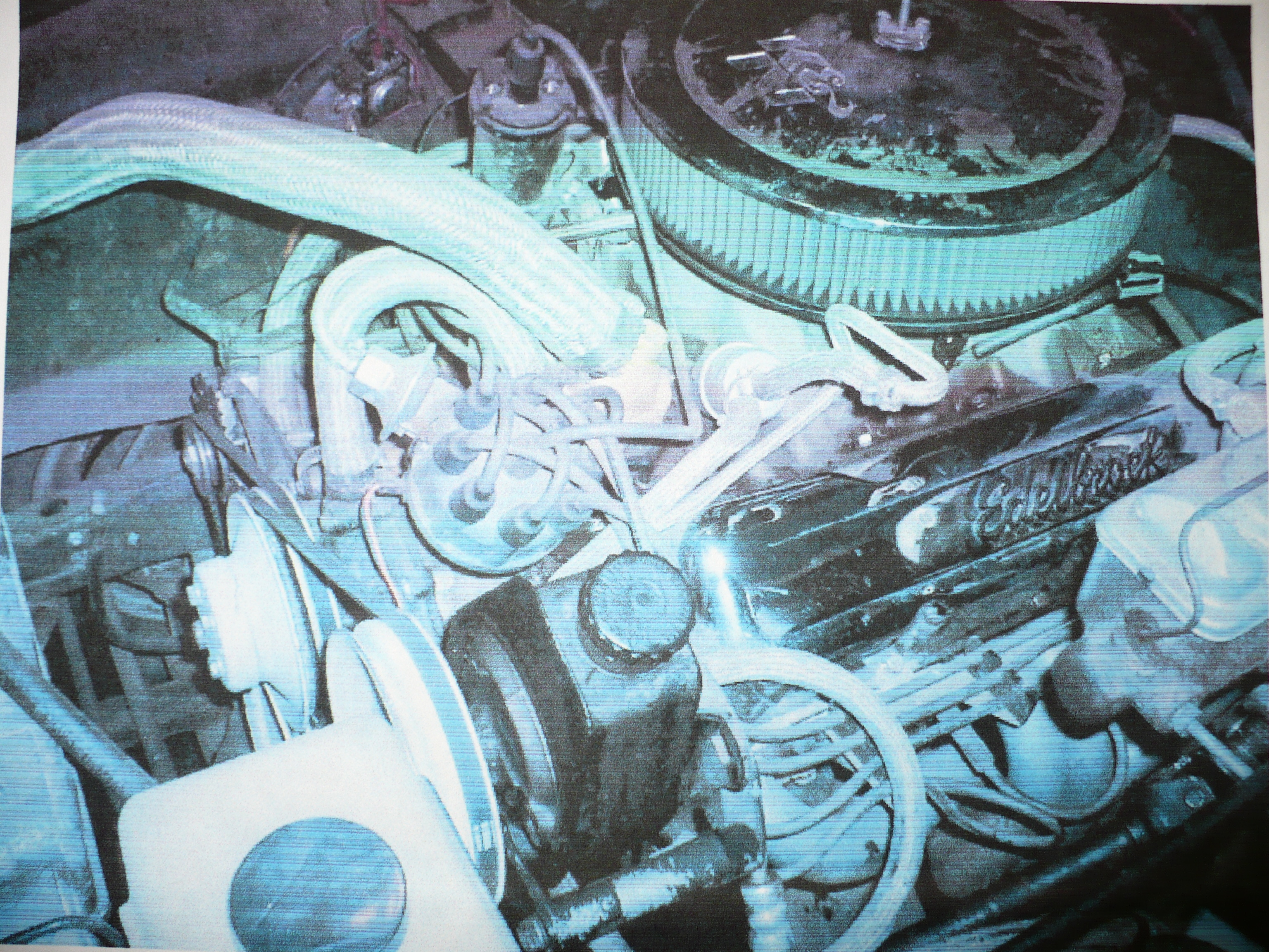

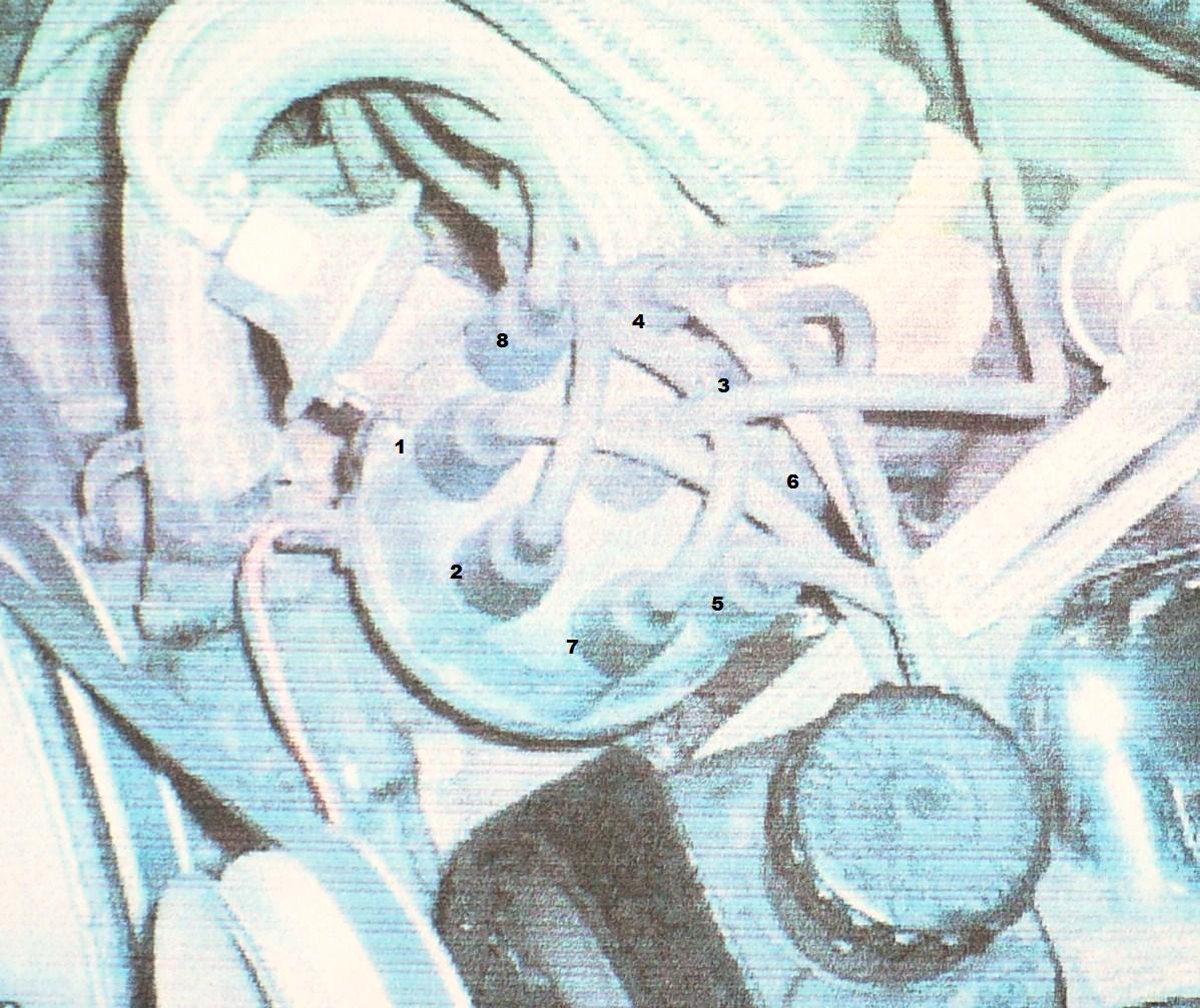

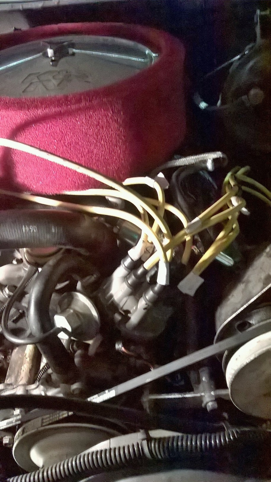

So, on another forum it's been called to my attention that given all the work on the carburator my issue must be with the distributor/spark plug wiring. Here's a few pics of what it looks like, any red flags?
<img src="http://www.jeepz.com/forum/attachment.php?attachmentid=21266"/> <img src="http://www.jeepz.com/forum/attachment.php?attachmentid=21267"/> <img src="http://www.jeepz.com/forum/attachment.php?attachmentid=21268"/>
BWAhahaha. Oh sheezzzz That explains my confusion.? Number one on the distributor points out to the front of the engine.It's an AMC 360, JPN
