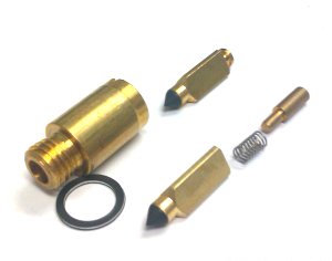

I got some vinyl tubing and a funnel and tested the Needle/Seats with the Air Horn inverted (gravity working on the floats) and ran fuel down the line.
The Primary Needle began leaking right away. From the many rebuilds of other AFB's I had a small collection of Needles and Seats
so I swapped out the needle and it held fuel. I don't know if I'm out of the woods yet, but this is just one more thing that was wrong with this 9638.

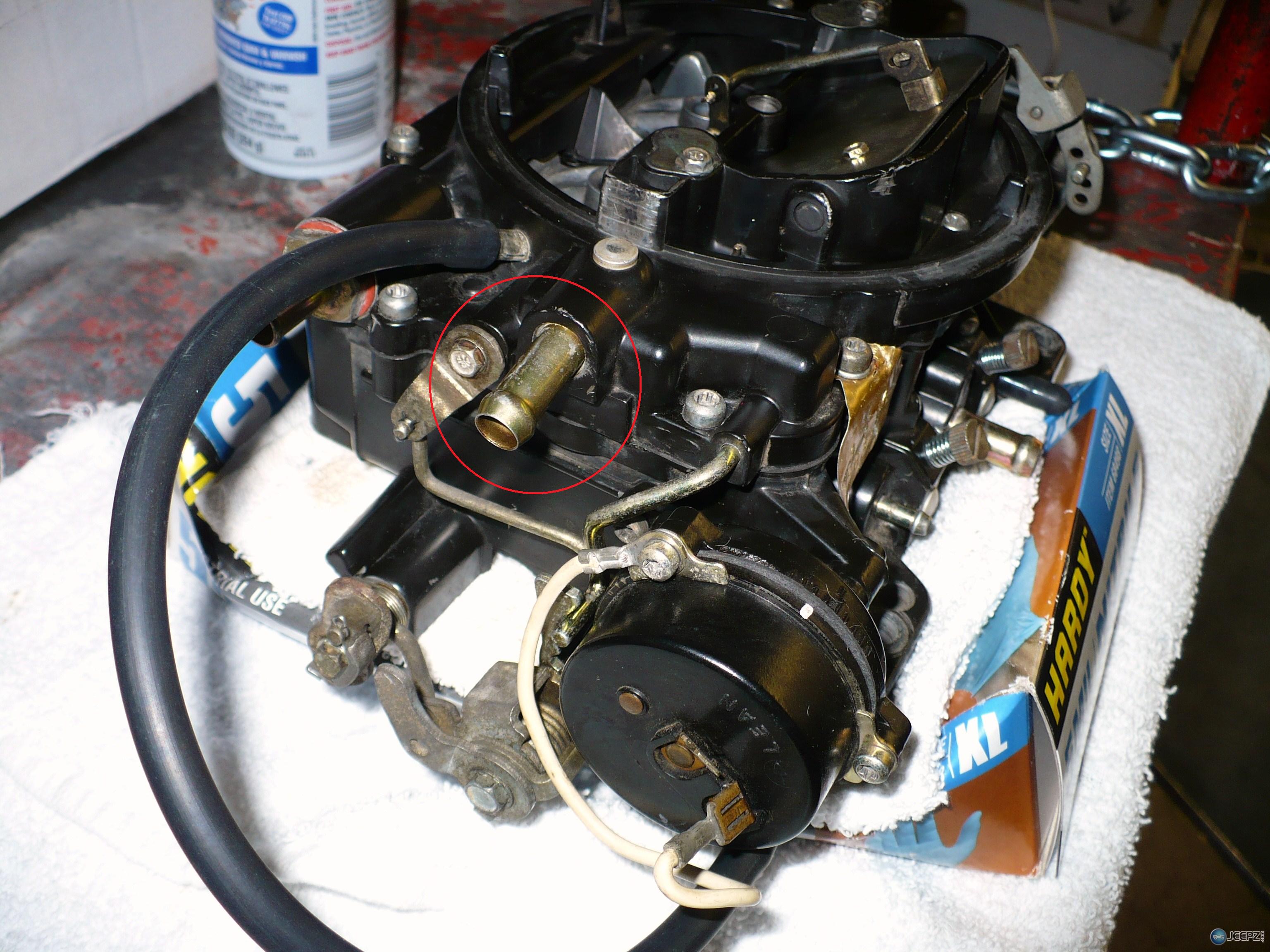

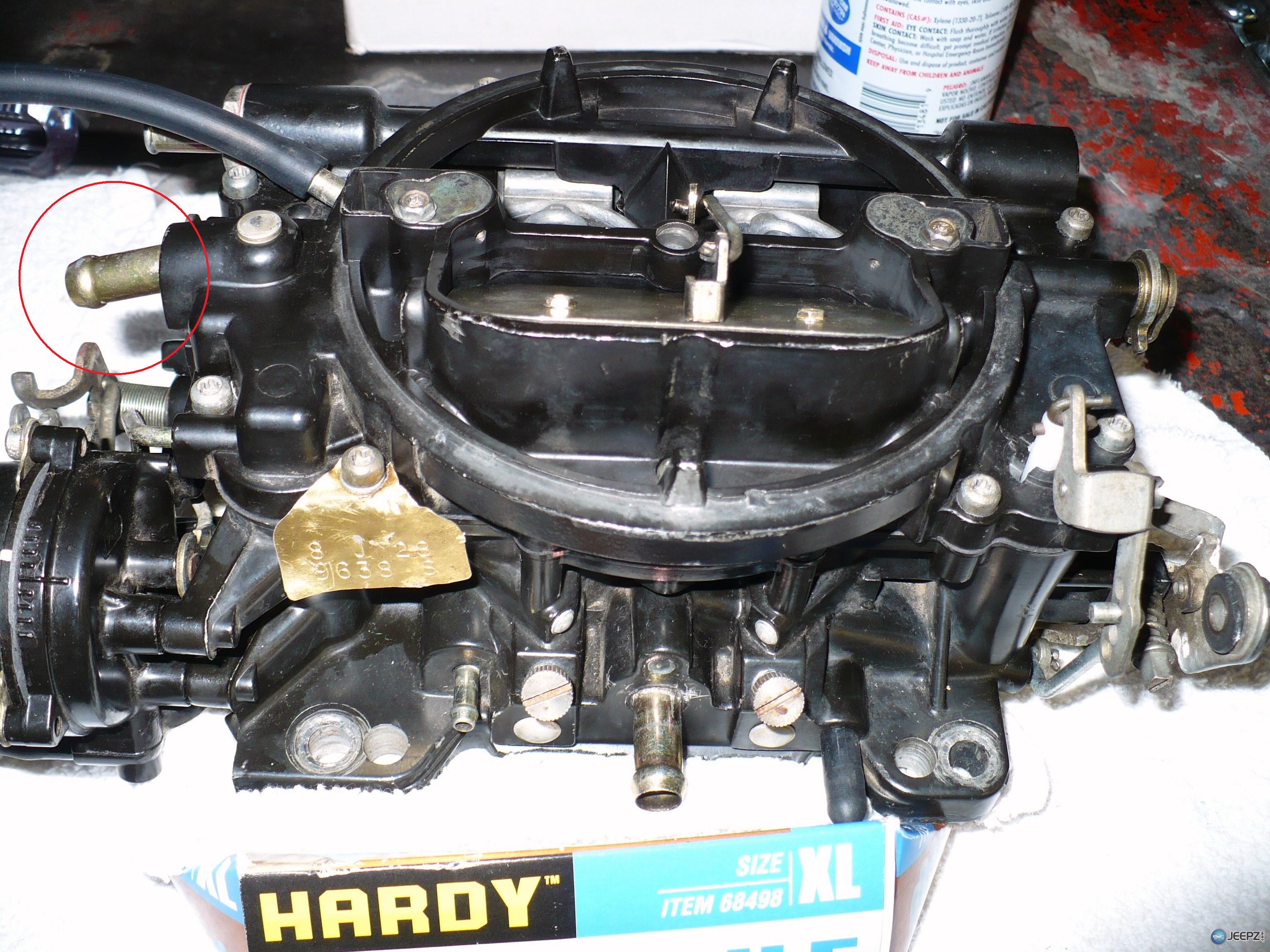

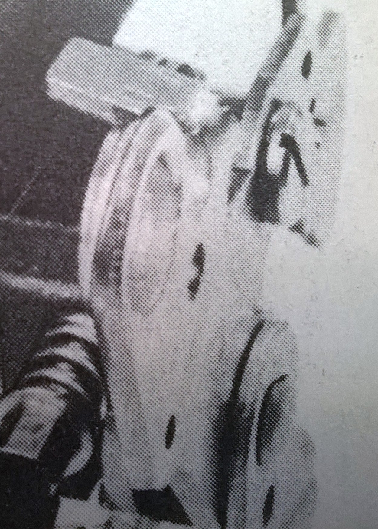

<img src="http://www.jeepz.com/forum/attachment.php?attachmentid=21516"/><img src="http://www.jeepz.com/forum/attachment.php?attachmentid=21517"/>
Did you have a question about the tube circled in the pic??
I didn't (Choke Fresh Air Tube) but there was one on another forum that reccomended adding a vertical extention onto the External Bowl Vent to inhibit fuel slosh, but I think he thought this was a Holley.
