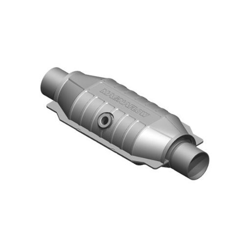

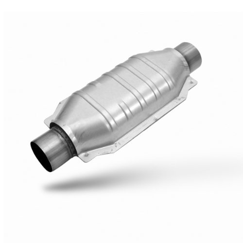

So the part I ordered came in (First photo: magnaflow #99005HM). I took it to a local shop and to see if they could install it. The mechanic said that it didn't have the O2 sensor port installed. I called Magnaflow directly to see if they have a catalyst that has the O2 sensor port installed and said that this product (Second photo: magnaflow #99055HM) would work since it's also a 99000series. Does anyone have this on their rig, specifically a 97 2.5L TJ?

I never seen one with the O2 sensor in the cat itself.When mine was redone we just drilled a hole in the pipe and welded a nut in place for sensor.

Yeah, i'm at loss to see if I should get this product# or go with a new brand instead. I also went to check my cat converter and saw that the O2 sensor is after the converter.
