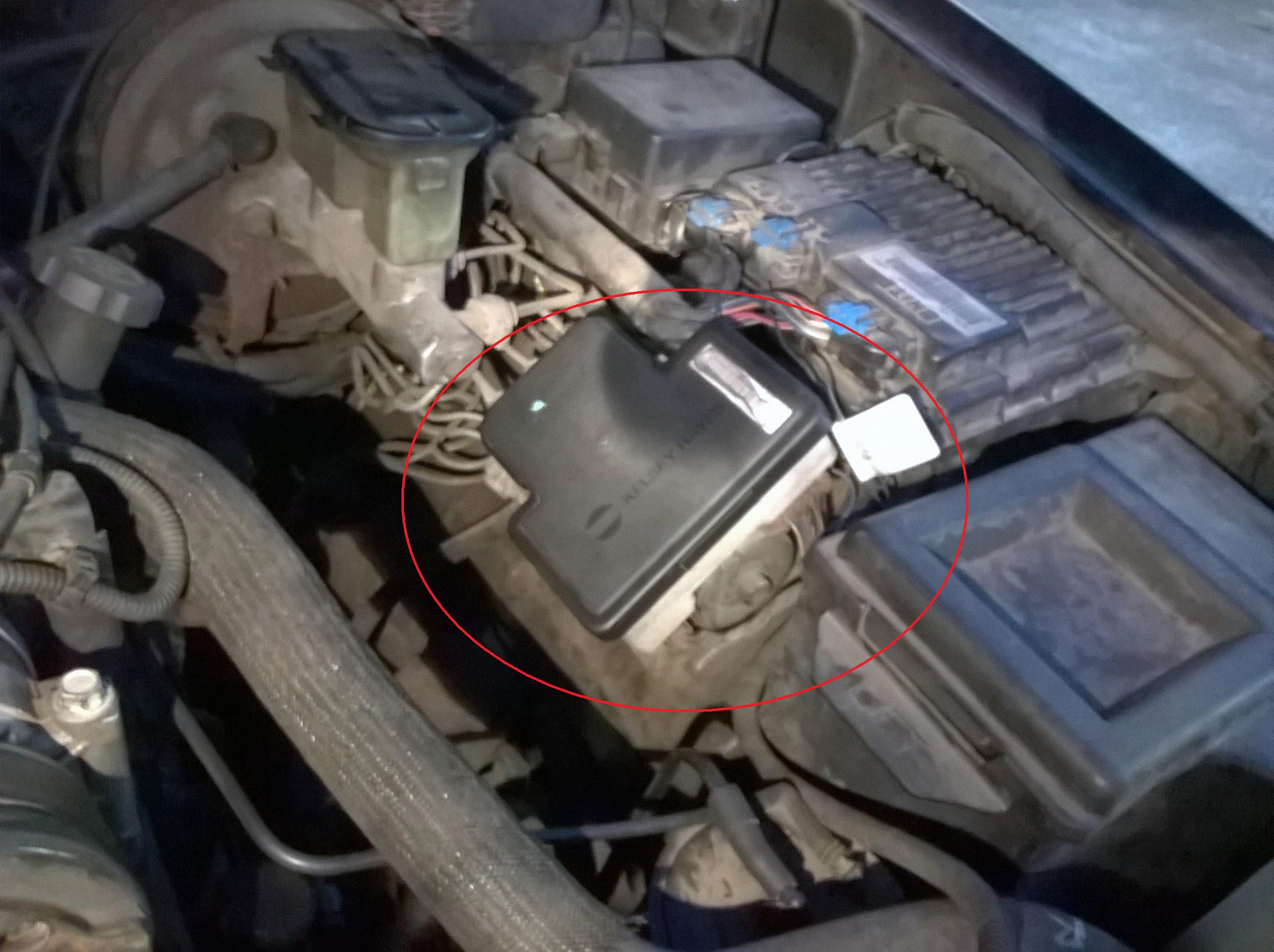

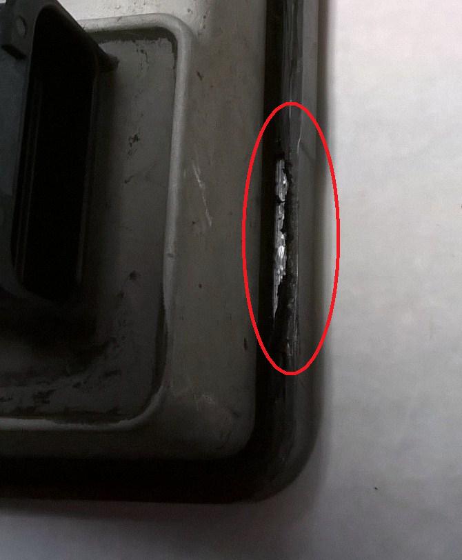

After the wiring I'm going to0 try again to open up that dang ABS ECU and see if I can resolder some connections, Getting that dang lid off is sure being a challenge.
